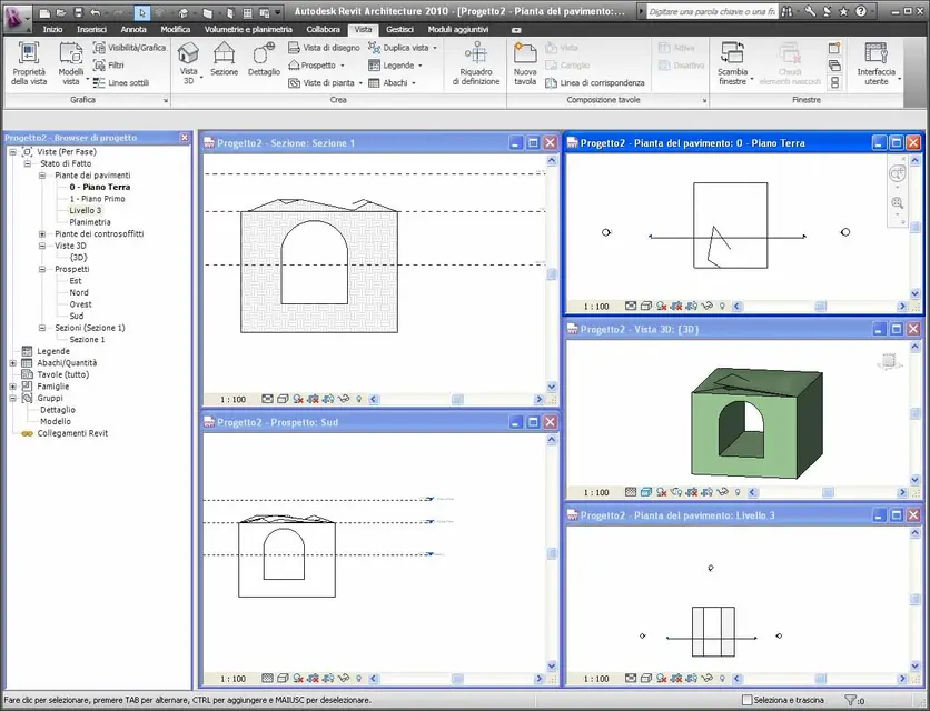

well I have my topographic surface and I have to create inside a tunnel with a vaulted cover.how do I do?
what does it mean surface of a few cm?insert a platform, which base of tunnel support, do your tunnel with an extrusion on path (e.g. structural family),indis:
- if the extremity of the time is on the floor, insert a "floor" up to the level of the ground, with "earth" material;
- if the extremity is also an arch, insert again a "fill" (always with extrusion on path) to which material checks "terrene"
or

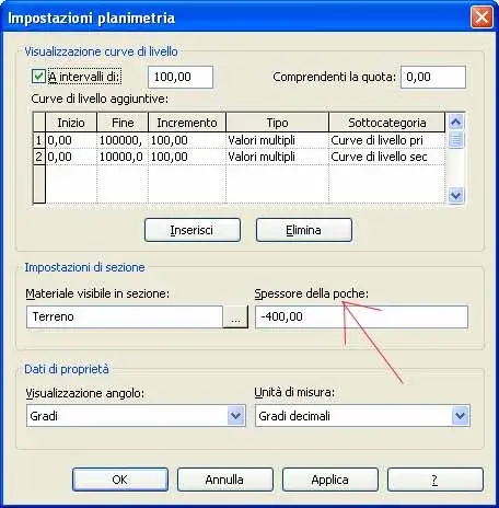

- make the topographic supeficie with depth of a few cm of "poche"
- under the topographic surface do a "solid" (extrusion) of the thickness you need
- use the blanks to "dig"
- uses solids (extrusions) for vaulted structures
of course the solids of the structures will be assigned the various materials (cls, etc.)
