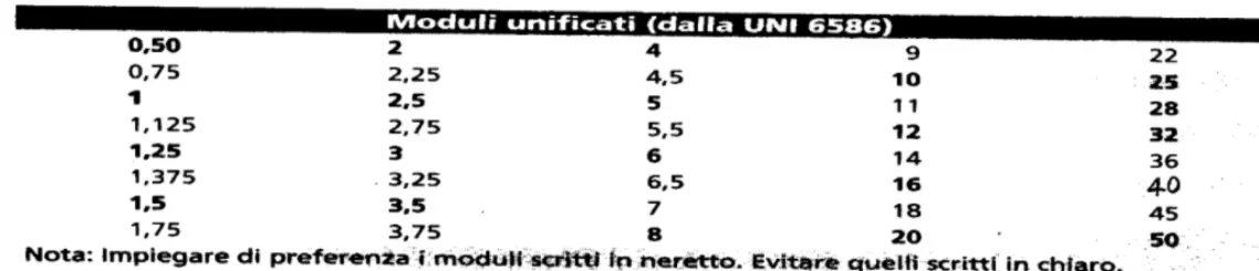

in the choice of the module, the unified module table shows some not recommended, and others strongly advised. What weight has this indication?
For example, I find myself having to choose between a module 6.5 that guarantees me the least possible encumbrance (recommended by hertz report considering a number of pinion teeth of 18), and a module 6 that is much more recommended than the previous one. However, using a 6 module (recommended with a 20 tooth sprocket), the maximum ingot increases by 42 mm.
how much does the choice of the module weigh in this circumstance? and above all, what is the preference of some modules compared to others?

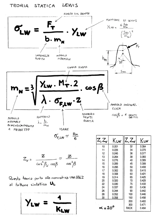

purely school audits using the theory of lewiss for the bending of the tooth and/or that of Chestnuts for specific pressure are not suitable for the evaluation of a real gear. In addition, many myths have been exploited in practice, such as that of the realization of gears with the first number and other things that have historically been indicated but that on the practical side they do not have major problems of operation.

I attach the table where preferential modules are indicated boldlywp_ss_20170107_0001.webppersonally I would try to optimize the couple of gears of minor encumbrance maximizing the characteristics of the gears themselves, therefore m=6, z=18, x ~ 0.6, material 18crnimo7 cemented hardened and rectified, widen band b, possibly widen of only a few millimeters the operating entirex if possible to carry out x>0 for both gears.

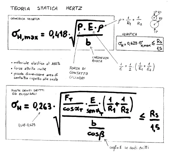

lewiss theory, as written in several of my posts, is calculated as follows:lewiss.webpthe theory of hertz is calculated sohertz.webpAs you can see, there are high security factors and you do not take into account anything else.
