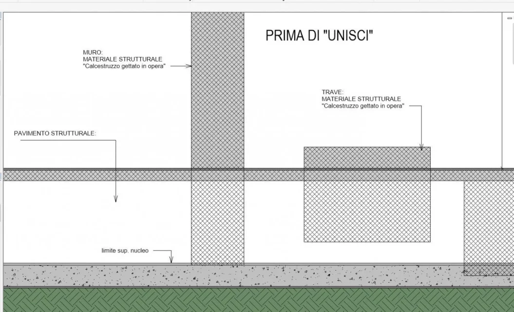

Good morning to all,
Does anyone know how to tell me why by joining a structural wall to a floor, the floor is properly cut and instead by joining a beam to a floor the beam is incorporated? I set the structural material of the beam in "calcestruzzo - thrown into operation", but it is still incorporated, as seen in the images "before" and "after" attached. thanks to those who will respond. . .

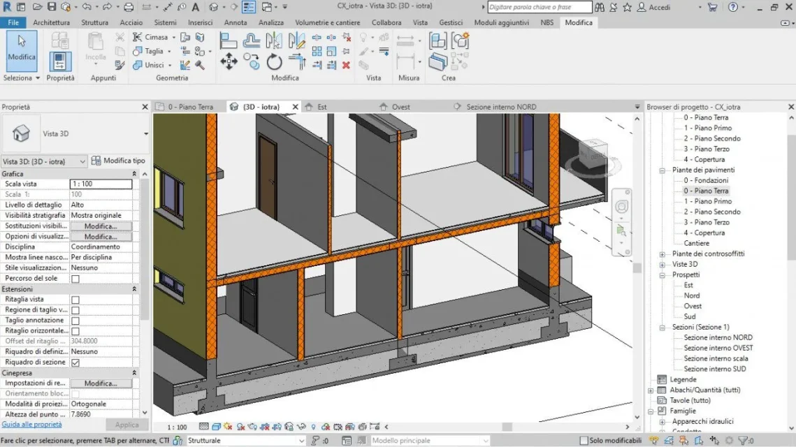

@tristan Sooner or later I'll have to get rid of myself, but I'm doing a bim-based sustainable requalification exercise and I have some problem, I hope you can help me:
I divided structures and architecture into two worksets (frame building c.a.).
the ground floor is in structural, with the layers set correctly
where I interrupted him to insert the cord in c.a. on the base of the brick wall I can combine foundation beams and floor correctly, on the central foundation instead if I operate union (after an afternoon spent to reverse the order of union o_o°) the layer in gravel incorporates the ribbing of the beam. If he eats it.
Should I interrupt the floor at any internal wall/width or do more orthodox methods exist? I guess I can, but I can't handle it.
as regards the beams of the floors instead the side ones are resized (within the thickness of the wall) after having joined them with floor and wall, the central one instead disappears. also here, the floor is a single plate interrupted in correspondence of the partition walls between u.a. (which rest on the beam, according to the constructive logic of throwing the structural floors, erect the buffers and then make the screeds - those in img however are internal partitions correctly joined to the loft)
and I can't use the controls changes joint (in beam-pilaster or walls), in no sight.
can it depend on the project template I'm using?
I initially had made two separate structure+architectural files, then I decided instead to use worksets because the building is not too large and I find myself better, I even managed to unite walls and structural pillars xd
but with the beams I just can't and I don't understand. . .
(The version is 2019)
Thank you!
I solved!
changing the analytical behavior of the beam family material from "calcestruzzo" to "prefabricated concrete"! It was so simple!! !
