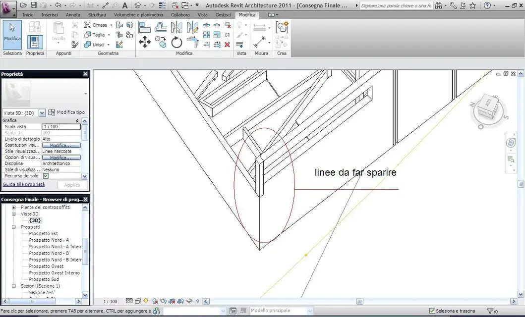

Hello everyone!! I wanted to ask you, I find myself with the following problem: I have two walls, one from 30 cm and one from 40 cm, which are in union not to 90° but with a lower angle. of these two walls the first is lower while in the second is higher. Moreover, the wall from 40, in the point of union forms a pillar to which a rectangular opening must start. all in place here is that when I go to create the rectangular opening (which incidentally I got with the modeling of the profile of the wall) this must have the side that goes to "attach" to the pillar with the same angle of the tilted side, but unfortunately I can only get it with an angle of 90 degrees regarding the long side.. I therefore had to resort to the modeling of the extrusion pillar that solves all the problems supposed to me, but in view 3d and 2d it does not "blode" with the wall created with the walls of revit, and unfortunately remain lines that in reality should not be there.. I also add that the extruded wall was created by obviously choosing between mass modeling the voice "hard". Does anyone know how to get around the problem?? I attach images that perhaps clarify the situation better. thanks to all those who will help me!

hi gfrank! for what concerns the architectural pillar now I try, while regarding the wall with the size of the pillar as I do, since the wall is created as a rectangular with 90 degrees relationships between the sides, while to me as saying they also serve sides with lower angles?
