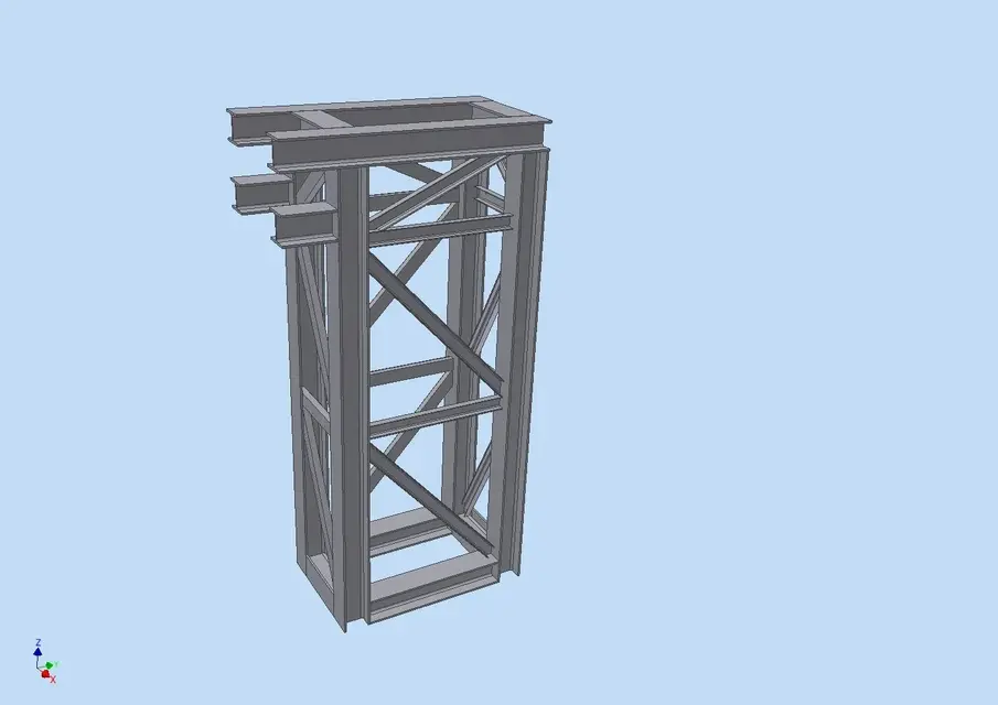

I have a welded frame that is slowing down all the asses at crazy levels, every time I move a platelet I have to wait 30 seconds minimum.
is it possible to "explode" losing the chassis feature but maintaining the individual components?
here is the frame and its layout

sure that the frame has no construction errors?
type cuts/extensions of profiles referring to non-existing faces or other features of the generator no longer correct... because as a frame it is very simple and certainly not normal a similar behavior. . .
There are no mistakes.
the problem is to bind external plates to the existing frame within the same welded assembly.
if I create an additional welded set in which I insert as subaxieme the frame, then adding the plates to the assieme father disappear all the problems.
According to me it can depend at this point on the fact that the frame has made it become a welded and therefore it can weigh too much the file. In fact I would do as you suggested in the sense of doing one to the other together in which to fix the frame and the plates.
