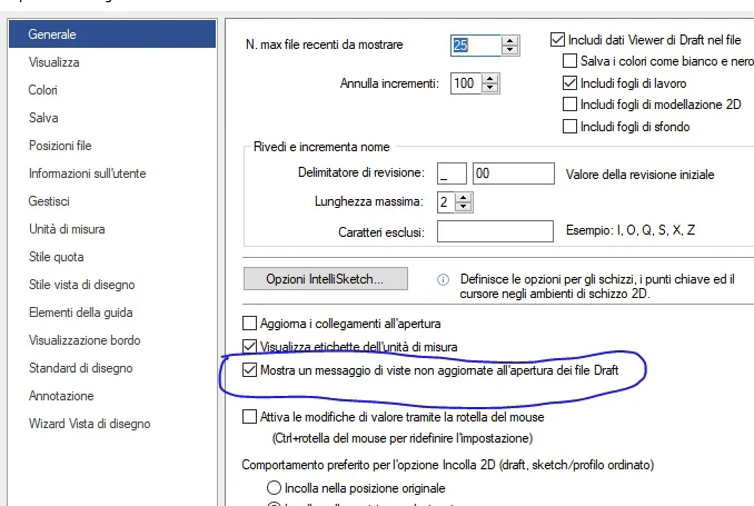

I'm sorry for the rash, but is it possible to update views not working? exists a way to tell him that he has to update the views when I open a .drf file with the point and stop!?
I open a file and you don't tell me anything about unregistered views? but is he lawful?
if I do not click on updates from the view and sometimes I climb on developments with updating by entering and going out into the part it makes me disasters!
hello, I'm talking about if 2023, are there any messages that should appear to me when the views are not updated? Is there a way to force the update of the views also and especially developments?, I don't know if it's normal but I don't update them if not forcing and entering the model from the view

As far as the problem is concerned, I do not have any changes in the reporting mode seen not updated than previous versions. undated views are contained in a pane; if they have marked edges means that parts have been updated in previous levels but never the assemblies in which they are contained; for this there is the tracker views of drawings that helps to understand which documents have been updated and which require update.
Finally, in rare cases a view may require to be regenerated, to do this you need to hold down the shit and control button when you press up to date.
