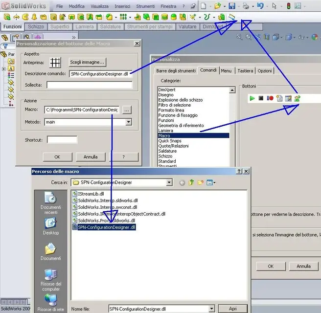

ho lanciato il setup, ma ora se preso "s" si apre il micro menù.... ??? e mò???

when you have installed this software start solidworks. open up for example part and click "s"-button on your keyboard when nothing is selected in sw. small menu is displayed in sw, click right button on your mouse on that small menu and "customize"- option should be available. now link new macro button to menu from "commands"-> "macro" ->"new macro button". in this window you should be allowed to show macro from "c:\program files\spn-configurationdesigner\spn-configurationdesigner.dll"
hope this helps!

I launched the setup, but now if taken "s" opens the micro menu...????? What about me? ?
Actually, after installing the software, you should create a macro launch button that goes to the request. see if the attached image can help you.
the fact of pressing the "s" button to launch the command I think refers to the fact of launching the macro from the "spn tool", a set of instructions created by the developer (additional) that speed the use of swx. If you don't have the spn tools you have to launch the program as a macro, from the special box you created.
