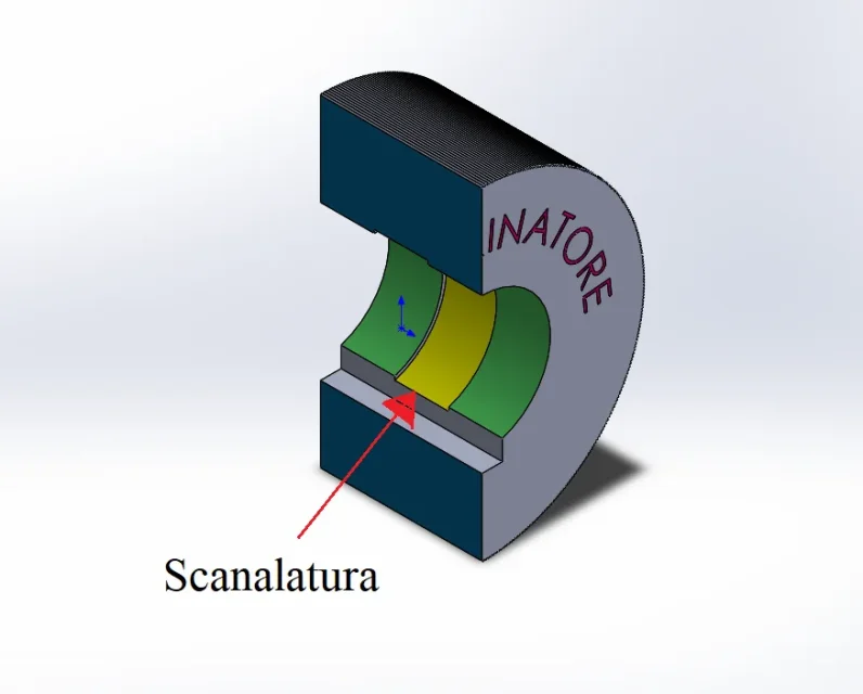

Good afternoon.
I am inside a metalmechanical company and I fell my eye on the hole of a cylinder/zigrinate roller, as in the image below and its sw dissected pattern (so you can understand what I mean).immagine per cad3d.JPG Domanda Cad3d-modificata.png
mi chiedevo:
  • la central groove What do you need? do you need to facilitate the insertion of the component on a tree/hide? I imagined the roller without groove and, if I had to put it on a spindle, it would be more difficult to match it than a roller with the groove. other thing is that I think I realize a hole passing on the roller without groove, with good tolerance, is more difficult than one con scanalatura (because you've got a long stretch from the other case).​
Thank you in advance.
the centering in tolerance you do only on the two outer bands. in the middle is discharged. it is necessary not to have geometric problems we straightness of the hole.
also the female serious commercial gearboxes have the unloading in between.
this hole with central discharge allows to make better geometrically and finish the hole.
during the shaft calettation flows better and you have less impurities problems.
this hole with central discharge allows to make better geometrically and finish the hole.during the shaft calettation flows better and you have less impurities problems.
the centering in tolerance you do only on the two outer bands. in the middle is discharged. for use do not have geometric problems we straightness of the hole.also the female serious commercial gearboxes have the unloading in between.
so I got there more or less.
Thank you. @meccanicamg for taking away this doubt.
in the next few days I will sketch my post #1, so that those who read or read will better understand this subject.

I am inside a metalmechanical company and I fell my eye on the hole of a cylinder/zigrinate roller, as in the image below and its sw dissected pattern (so you can understand what I mean).View attachment 71592 View attachment 71593
mi chiedevo:
