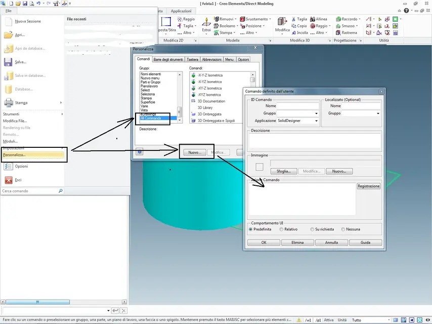

I was looking at v18.1:
Do you have any idea how to add a custom command? for now I only managed to create a new tab and add a new command and its icon. The problem is I can't add the text to the command!

In the end I found the way to create a new command, once this is done, just create a new tab in the ribbon bar and add it, taking it from the list of existing ones.

I'm just testing with model manager, I still have to use v17 for work because pdm eit doesn't work with v18.
However the modeling ribbon seems to me much better than the ribbon of itself....
you can reuse the old toolbars (file *.tlb) defined on v17 directly on v18.1, just copy them to the folder:
c:\users\appdata\roaming\ptc\creo elements direct modeling 18.1\18.1
and recall them from the file menu-->personality-->bar of tools
