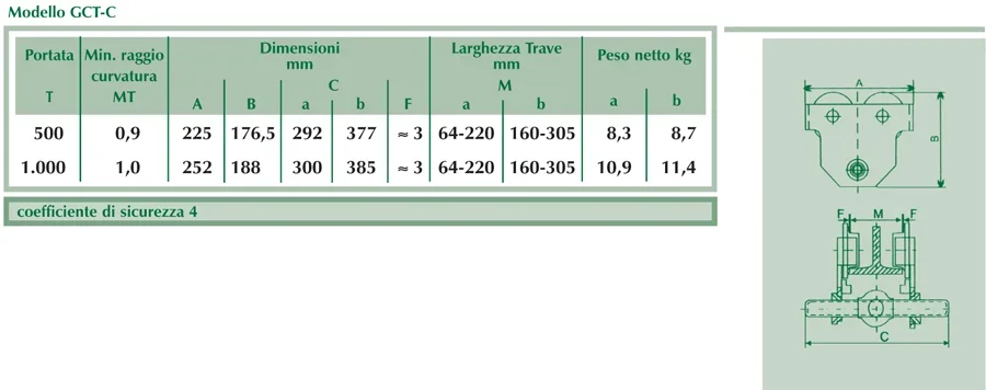

an example qui.
What's wrong?scheda_carrelli_a_spinta_modello_gct_c1.webpfirst you need to recover a good catalog with dimensions and moments of inertia.
for the size we are qui:

an example qui.
What's wrong?View attachment 64537first you need to recover a good catalog with dimensions and moments of inertia.
