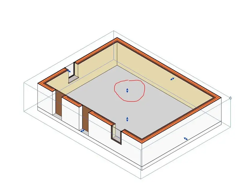

I add another question:
When I insert certain objects, like the tap or sink, they are not always at the right height.
I was quick, but I couldn't raise or lower the object.
How do you do that?
I tried from the side windows, but since I have perimeter walls, I can't bypass them from the view and go inside the house to see the object.
thanks to anyone who can give me some answers!
then I'll coach you the example go to view 3d and snack on the extensions. for other questions look on the forum and you will see that you find the answers. Hi.

but I couldn't!
Also to do as you say, when I move the tap or turn component, this moves forward, back right or left but not up or down!:mad:
