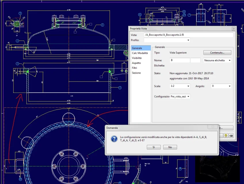

example of configuration aimed at the setting of a particular boiler:
- cockpit catch-0, raised cover for the constructive table
- catching mouthpiece-1, constructive table constituted by the view in the main plant from which the various sections are dependent.
in the view in the plant, for a correct visualization of the flyers of the gulfs, the configuration should not be activated, otherwise they would see the flyers under the flange. when you want to create or change the main section you need to activate the lifting configuration so that you can detach the bottom and get a space for the odds. after listing the dependent sections, the plant is updated again by deactivating the configuration.
This example is very dependent on the boiler design conventions where many views are grouped on the same sheet without creating many separate sheets.
