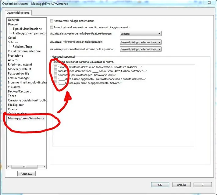

2 - I have the need to run the section and then delete it while keeping the indication (top track and arrows)... once a dialog box was deleted, which asked me if I wanted to delete or not even the section line. stupidly once I answered yes and clicked on "don't repeat the question"... does anyone know how to restore the window?

to restore the window and all messages look at the attached image.
putting the check restores the options you had previously deleted.
