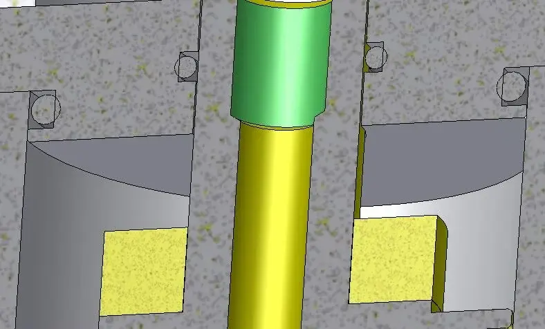

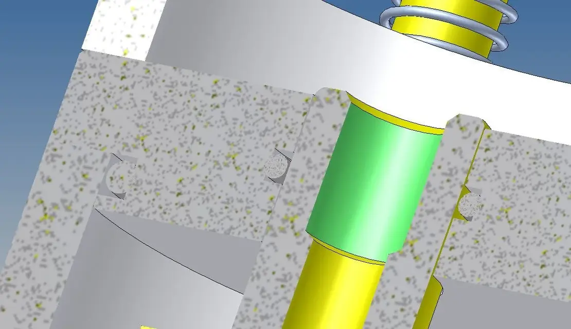

when I make a view in section, the corners of objects appear as you see in this imagesezione1.webpwhile in the pc of an external collaborator, the same section presents itself with the well defined edgessezione2.webpI tried to clench in the display 0ptions but nothing happens. .
Do you have a suggestion? whether it is an inventor setting or the different graphics card? Thank you.

in application options, to the hardware item I set "compatibility", if instead I put "performances" it works.
the point is that if I put performance on the "PC performance" (you hear the word game) they get ugly.
See, how I told you qui, the hardware compatibility mode for these and other reasons would avoid it.. .
I remember it and I am convinced that it is more correct to put "prestations", is that there is something that I do not understand, when I put that mode I can no longer manage/route/zoomare with the great assemblies... then time to do tests etc. there is no, so go with "compatibility" that all in all allows me to buffer the problem. Thank you very much. Hi.
