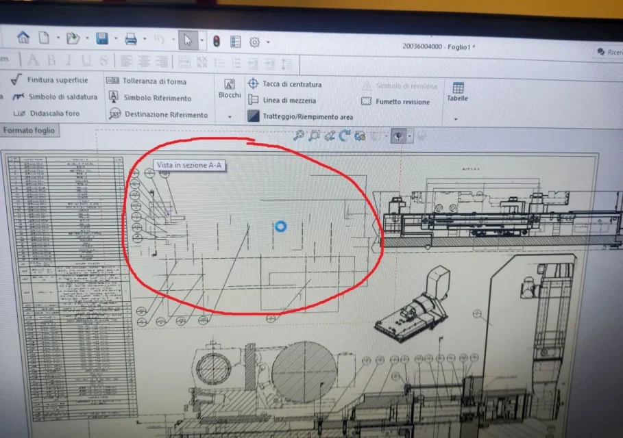

on a heavy table, at the opening known this strange behavior.
the view does not appear, then after reconstruction there is, but I would like to avoid.
Think it's a graphic driver problem? It's actually heavy.

I think it's not the driver. understanding the reason for this behavior is far from simple.
I see that some views are yellow in the tree on the right, and the problem is that the section line fails to get a definite figure (problem that happens to me often).
I never understood in detail how to avoid that mistake.
to make my considerations I would like to start from the "clean" design without errors.
What can I check to make the section line not make mistakes? in my case a decomposed section surrounding the entire design.
from what I remember this happens when slidworks fails to dissect a part; I usually had downloaded components (cylinders, engines...). Unfortunately, the only way to understand what creates the problem is to exclude a component at a time , starting by checking that it does not have components with surfaces, then you can do a mini together with the only components crossed by the section and, if the problem is resumed, eliminate one component at a time. It's a laborious process, but I don't know other methods.
