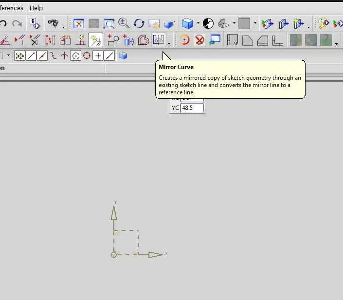

with the appropriate command.
I'll put an image on it.
the datum with which you will mirror the solid must be before the sketch that mirrors naturally.
