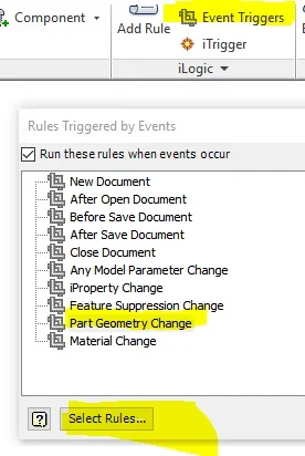

you can dynamically display the volume with ilogic.
here are the operations you have to perform:
1) creates a user parameter named "volume":
2) Add a rule:
3) crea un trigger
select "continue" in case you see an error
5) view form
at this point the value displayed by the form will be updated automatically.you can save the file as modified between templates to reuse the whole.
