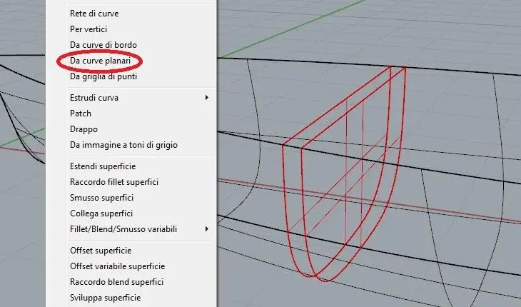

I can't understand where I'm wrong? I have to do something that should be simple. . .
the flat surfaces for the faces of the wallpapers I can get them, is the next step I miss. I don't understand what to do the sweep2
Thank you, I had done the search for the fourth, not the fourth, sometimes just a letter. .
for richer: once you make the two flat surfaces you have two possibilities to join each other and make a closed polysurface (solid):
the first is to use the hull itself by cutting it with the two plane surfaces.
then cover the hull and then trim it with the two surfaces holding only the hull slice between the two surfaces.
the second is to sweep two rails between the edges of the two surfaces. The difference between the two methods is that the first is accurate. in the second straight suppose a hull generator that could have a curvature. Of course the mistake is very low because the fourth grade (I learned the ternime) is still respected.
thanks wave, with the system of cuts I understood how to do and finally I can get the bulkheads and everything. Now I have to apply for currents, but I think the procedure is more or less the same. or with the intersection I get the track, I draw the profile and make a sweep. then I cut the bulkheads with the current I get and I have the ready piece to be cut into the machine. I just have a doubt. but so doing the currents sell exactly parallel to the ground while instead they should have a curvature.

Just a curiosity. but the result of a sweep1 that crosses a surface, can you cut it with the surface itself? If yes, with what command? I think truncating doesn't work. .
I don't understand the problem. if the surfaces intersect, you can cut. Be careful to try to use single and non-polisuperficial surfaces that in cuts often fail, better make three cuts with single surfaces than a cut with polysuperfici.
I use the commands in English I would tell you _trim or _split.
sometimes with the split (that the same command of the trim but does not throw the cut part) things are better.
Try to tighten tolerance in options and verify that the surfaces are valid in the property tab.
