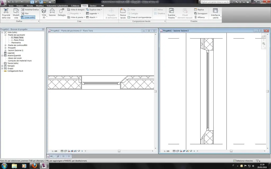

Can anyone tell me if it's normal that in section you never see the wall twist to the inserts? I do not understand if I am mistaken, whether it is a defect or if there is a technical/constructive architectural reason (e.g. it would be correct to insert a little face or similar).

in the section, which inserts do you refer to?
If it's a wall and a loft, you need to use the command : merge geometry
otherwise send an explanatory image
as an insert, in this case, I mean a window.
I created this one. He's got some parametric shit.

I also found this problem, the ripple of the plaster is made in the plant, but not in the vertical sections, is there someone who managed to solve this problem? ?
time ago I was given this solution (cut profile):
http://www.revitforum.com/forum/showthread.php?t=2963Obviously it only partially solves the problem. waiting for further software side developments. . .
In short, it is a problem that persists over time, seen already with the revit 2009 I had noticed this problem and that at dawn of 2011 has not yet been resolved!!! :mad: more than that when you go in the phase of making you find the windows of another color.. It's not very nice to have a green face and find the gray window. :Mad:
