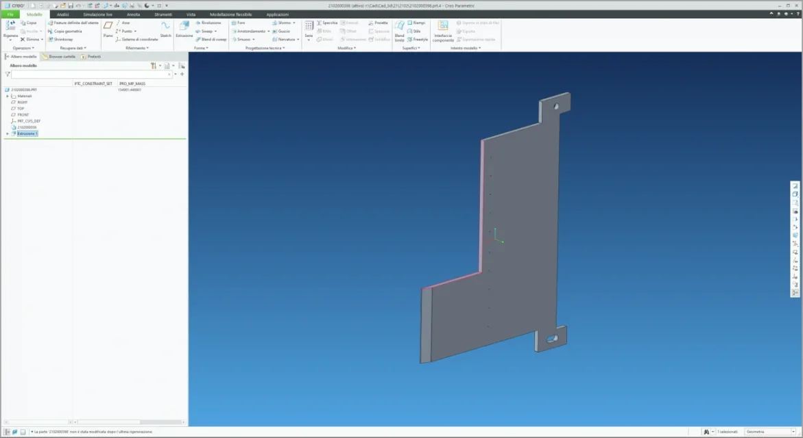

hi how you can see in the image the piece in union inheritance weighs 1,66 kg, while in the prt does not take into account its weight and gives me a disproportionate value not being set any material, but in this case should be that of the piece from which I leave.
How can I solve the problem?
But this doesn't happen if I do it together, after updating the value you told me.1632922259024.webp
If you have made the inheritance union you probably take the mass propitiage of the part you join.
then either check a precise material or verify that the specific weight is correct under the file properties.
in creo you can assign to a part a specific weight of default so you have a likely weight even if you did not allocate a material. I have always used steel.
It's likely that you have a specific weight a little high! ;)
