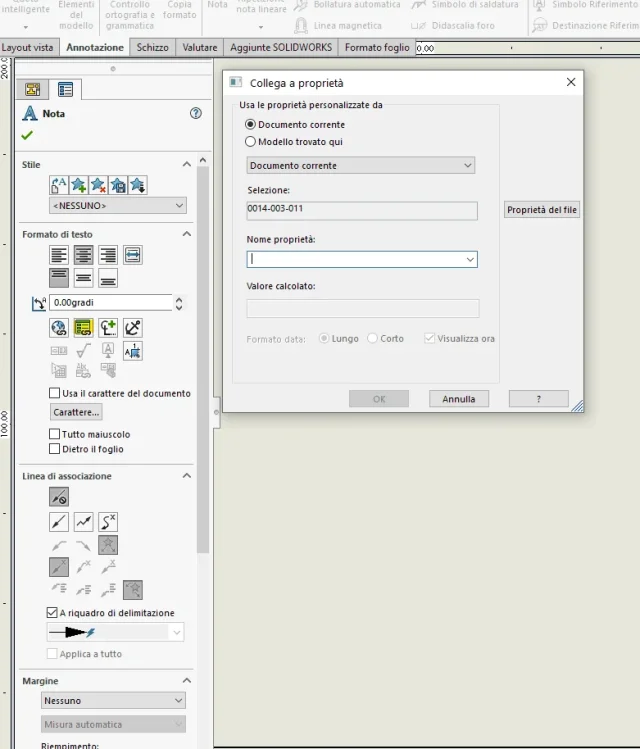

Hello to all, I find myself having to solve a problem related to the compilation cartiglio, in essence a customer asks me to perform the constructives of a welded, such constructions must be carried all in single table, of course every table will have in this way the cartiglio compiled in an equal way since the starting model is the welded. So I ask: is there a way to differentiate what is reported in cartilage with regard to individual components? For example, a sheet that is part of the welded in the table if you have the same data from the welded board, is it possible to do as if it were a assembled? obviously if possible not manually.
thank you all in advance for any given answers and good evening you.
I correct myself: it is not possible to insert inside the cartilage a recall to the property of a separate body of the cut.
you can insert a note link to the view and then, disable the director, place it over the cartiglio

I ask for clarification: for single table what do you mean? a single multifoil table file, where in each sheet there is a particular one?
Thank you very much maxi, I will do as you suggest you seem a good solution.

by single table I mean a single file for each particular, so a single sheet for particular with its progressive code, as it were a assembled and not a welded.
Don't you want to export all bodies like single files? in this way you could take you behind the properties of the separate cut that would come in the properties of the file.
to say the truth I had thought it too, but I should feel the customer, I see what answers to the mail, for now I proceed so, sincerely the best thing would be to do as I always did and that is a table with the quoted welded and then the various sheets with its details, but the customer decides to do as always.. .
I wonder: but because they never modeled all the details individually and then assembled in a set... strange things that I would call.. daily.. Let's say that...
because it is simple: modeling with welded is easier and faster, complications arrive with the table. If the table gives it to another the problem is solved. In these cases, I usually carry out the bodies, but the pdm gives me a big hand both in the export and in the maintenance of the connection of the graphics between external parts and bodies.
