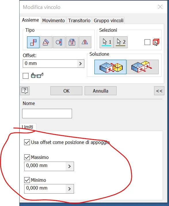

Do you have any restrictions with your springs?
(I attach you image though I'm sure you know what I'm talking about)
Yes, I'm afraid that's what troubles me.
If I take it off, it works better.
I regret not using it because it would allow me to make more real checks on the movements.
in fact they are useful as a tool but if inserted in complex contexts I can "salt"
