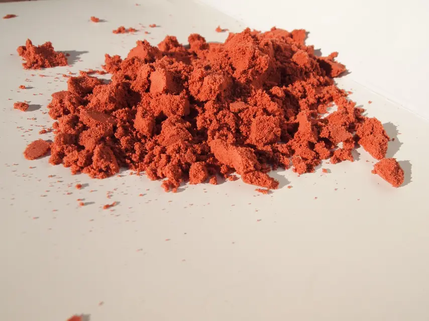

for external wrinkle you can use a red sand cap from foundry
and then fill the rest of the bracket with green ground
