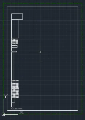

Hello, guys, I'm having trouble on the type of scale to use to represent a 100 meter high ground.
At first I had opted for a 1:400 scale, the problem comes out when I have to divide this portion.
I have to represent a block 100 meters high and divide it in turn, type 4 meters will be limestone, 15 meters fine sandstone. the problem comes out with the subdivision of portions of 1 m . would go out too small and you would not see anything

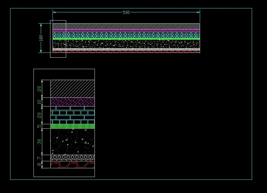

do the general view and then one or more details 1:100 or 1:50 or 1: cowhide in which you see well the split and size of the faults
I may have made a mess, so maybe it's better if you tell me step by step. I had done right button, options and had put on '' unit sign of origin''' and on '' unit sign of destination'' meters and I had made the design normally but so to what I see it is not okay.
- - - updated - - - -use autocad 2016 and are not very experienced of the program
sincerely I'm not understanding anything . I created a simple square of a sheet a4 and when I go into the print preview or it comes out too small or too big

drawings in space model 1:1; make the views in layout/paper space depending on the need. autocad thinks in unity: meters, centimeters, yards is a definition that you must indicate to those who read the drawing.

I admit I'm very rusty with autocad, but they told me to deliver such a job, and in the representation of small thicknesses I have problems because it comes out too small
ah asp, so you ask me to make more sheets to be delivered where in other ''zoommo' sheets for interested parties
