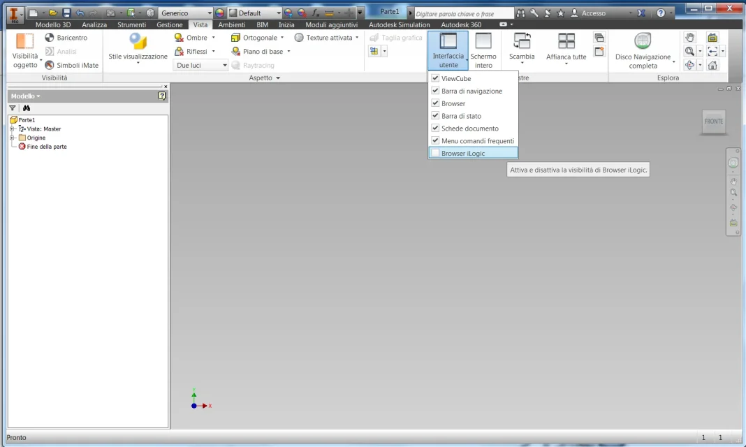

I wanted to ask if you can automatically make the ilogic module window appear when opening the file. Can you do that? ?
Hello:cool:
hello laura thank you for the answer I think I have not explained well.. I attach an example to be a little clearer. I would like that when opening my file, the "form1" window appeared automatically without going to activate it from the ilogic browser. I hope I've explained2.webpbye and thanks:finger:
Bye.
you have to use an ilogic rule:
1) activates the ilogic browser.
2) select the rules tab.
3) select the file name that appears
right under the tab rules.
4) dx key, assign a name to the rule you are creating
e.g. rule01
5) will open a window like vbasic
6) Enter this simple rule
ilogicform.show()mio _ module"
where mio _ module is the name of the ilogic module that
you want to activate at the opening of the file.
Pay attention to the correct correspondence of the form name.
Good job
Bye.
