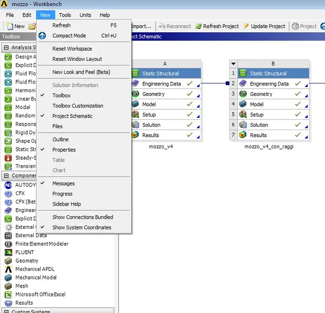

hello stefano and thank you for the answer. I have to do a static analysis. the first time I opened workbench I had the newgeometry button in the toolbox. Now this is not there. I was easy, actually, the first time creating a complex geometry. when I reused it recently I noticed that only the geometry command is available in the toolbox. I will read one of the links you have proposed to me but if I do not resolve I will be forced to contact you again:)

Maybe for some reason it is spu [Bleep] the main window of workbench.
see image attached to reset it (reset layout)
I'm sure you already know how to do this, but in Latin it says "repetita iuvant".
click with the left mouse button on "static structural" in the list on the left and drag into the working area that will light up with a green square.
from there begins the workflow
1-definite materials
2-definite geometry
3-mesh
4-setup constraints and loads
5-
6-postprocessing
