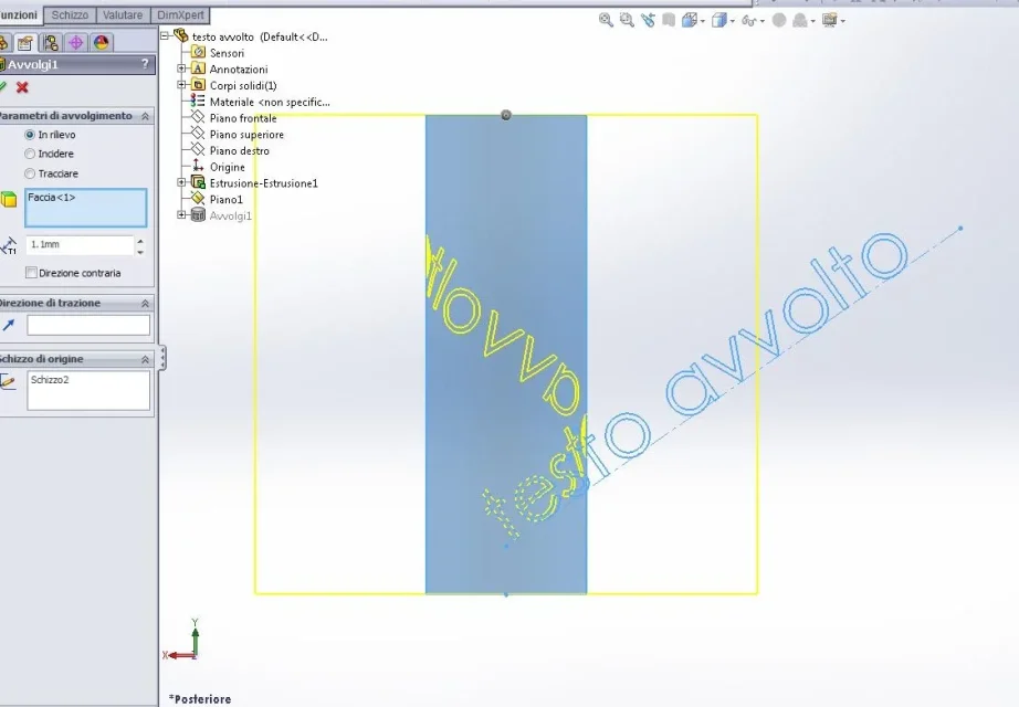

good evening to all, I have to do a job I thought banal but so it is not (at least I can't and googlando find nothing ad hoc):
I have a cylinder on which I have to wrap a writing, not only along the axis or only diametrically (i.e. do not make the text and use coils) but spiral.
would be like a sweeping winding to understand us, given the cylinder I have to orientate the text with a tilt date and wrap it around the cylinder with a spiral ramp.
to make everything more difficult there is the fact that it must be by force text since we should make several bars with different text for each of these.
I don't know if the explanation was clear, I hope so and that someone can give me a tip....I brancolo in the dark but the owner said I can (I nicknamed it easy.it :biggrin:)
rereading it was unclear even to me what I meant, the image helps to make the idea betterImmagine.webp

I don't know if I understand, but I don't think you need to shake the spiral. it is enough that you impose the line along which you create the angular text compared to the axis of the cylinder with the same angle of the spiral that will have to follow. idem for the starting point of the basic line of the text, which you will position on the appropriate level.testo avvolto_1.webptesto avvolto_2.webptesto avvolto_3.webp

and yes....this I had to get, only that having never used the text tool I could not and I went to complicate my life without asking me what the form "lines". when it is said to have the solution under the nose
Thank you, I have solved the problem.

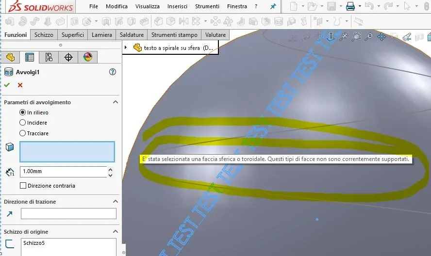

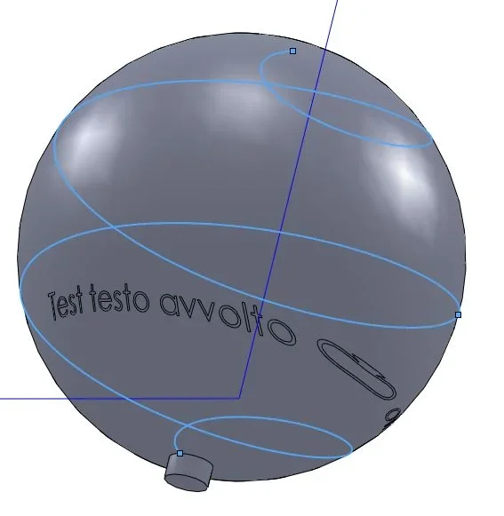

hi massive :) the winding function I also have in 2016 but it does not allow me to select spheres and toridals. could just write by following a propeller but it doesn't allow me to select the propeller... other way I don't know ... and you?
from 2017 onwards it is definitely more performing by spreading the sketch on a flat surface. here the speech is more complex because there is also the warning, but surely there is that with 2016 you will never manage to do it with that function (maybe you will not succeed in doing it in any way)
