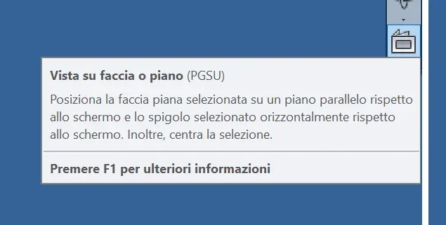

  • Peppe replied to the thread rotation sketch on the plane.
    you can make a screen by setting yourself up with this command compared to the sleeve?
