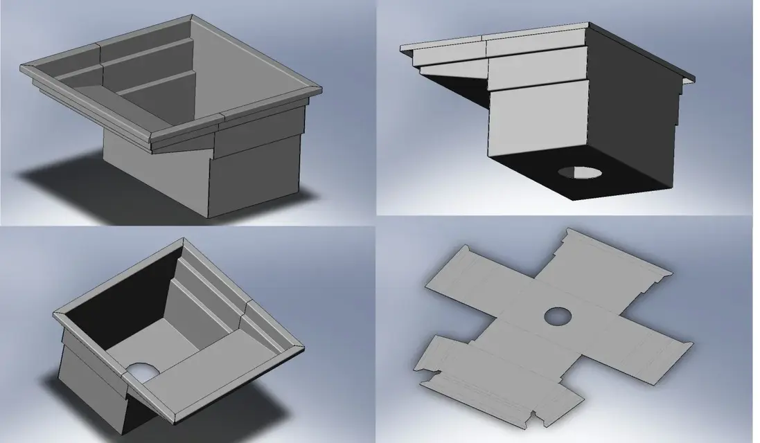

I'm sorry to introduce you, but since I'm trying to learn sw, I tried to draw the tub
I look at your comments and your reproaches
measurements do not match the real file
designed with sw 2010

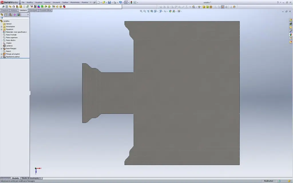

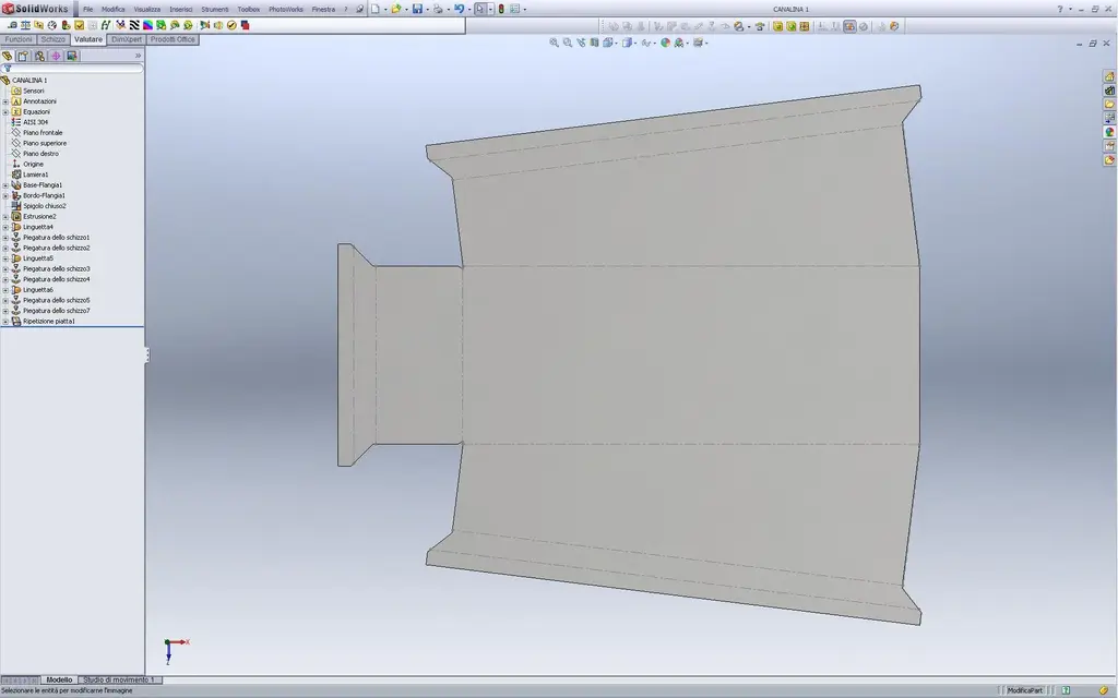

thanks for the explanation.
example: stainless steel casing sp 1.5 mm; in sldwrk: sp 1.5/ r0.01 factor k 0.0 12 mm quarry = perfect development even on 5 6 consecutive folds.
the same piece designed with radius 1.5 factor k 0.273 12 mm quarry...
But I did not understand this:confused:
was just an example, using different bent rays (in solidworks)
I have the parameters to achieve exact developments.
It's hard to understand if you've never worked at the counter.
to facilitate developments, the 0.01 mm radius will clear you many problems, other times you have to draw the piece just as it will actually come and then those two parameters I need.
