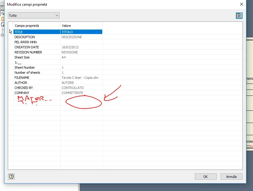

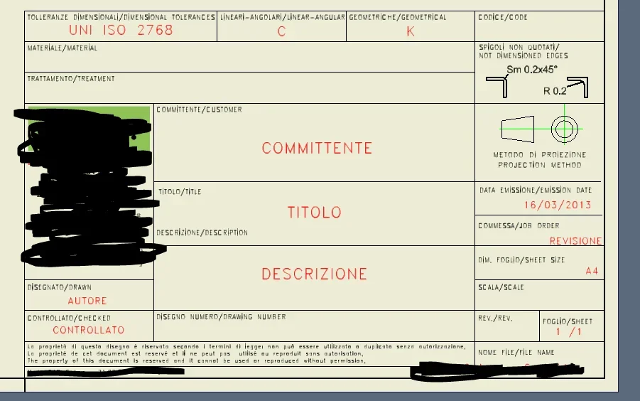

good evening to all, probably someone already answered but I couldn't find the solution. <
My problem is to add items (e.g.: material, treatment...) to the cartilage, but that can be modified by the iproperties of the drawing or by "modification propitious fields" as from images.1527697953663.webp1527697863748.webp1527697837196.webp
in the help it is written that you can not change from there, but you have to use the iproperties and various fields, maybe you should use some appropriate add-in

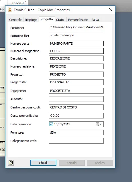

instead of using the i-properties of the part use those of the drawing.
In that way you can change the fields from "field text" in the table browser.

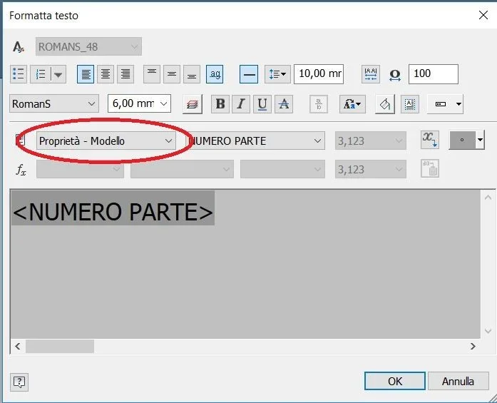

Hi, what do you mean to point to table i-props? ?
when inserting a text into the paperboard you point it to an i-prop, which can be of the model, of the table, a custom i-prop of the model or of the table, a required input etc.I-prop.webp
