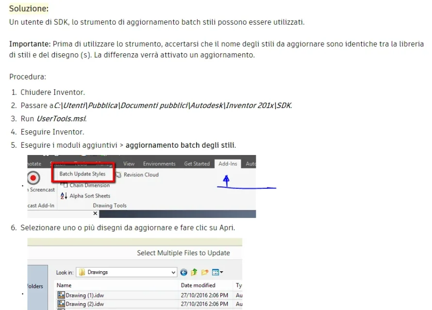

Good morning to all, I should update the design styles of several tables, but I did not want April 1 for one, then I looked on the net and came out this
1526363556974.webptaken from autodesk site, pultrop after the installation I am not at the add-inns ribbon.
Has anyone tried it before, can you give me any indication of how to get him out in the ribbons?? ?
Thank you very much
go to environments, additional modules and upload the application you have made the installation_foto__045.webp
