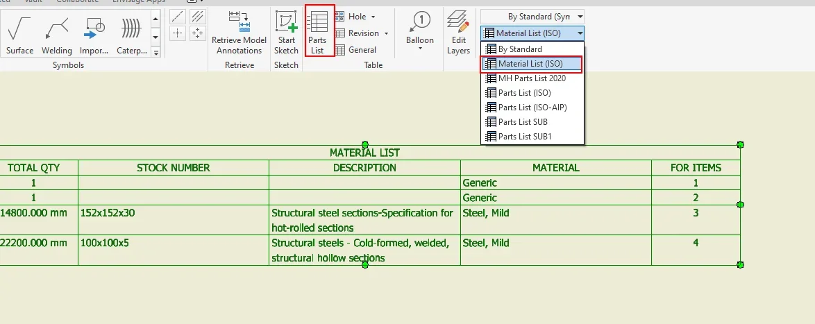

Hello to all boys I am making a structure of carpentry (a scale) so composed:
-4 legs all the same made with frame generator,
-1 landing made with frame generator,
-2 parapets also made with frame generator.
- keep some other details as grilled and ladder that I have to make. . . .
all these components are then mounted in a set as in figure.
for the realization of the constructive I would need to proceed in the following way (in one sheet):
-Insert the views of the board with a maximum quota (ok),
-insert an isomentric view (ok) tagged the component name (parapet) that was inserted under the field "description" in the properties of its axis (inserting the tag I visualize the decrition of the tube as from image),
- to create distinct components that group all the same profiles in order to obtain the total weight for each single profile (ok) but I would like to improve it by making sure that for example all the ipes correspond to a single number,
-create a detail to quote for all components ( legs, landing, parapet) I have realized the views by inserting the details starting from the axieme for example of the parapet (as from image) but at this point arises a problem, going to tag the components not corresponding to the components in separate (I have only checked the voice parts).
- as last thing even if it is not indispensable I would need to insert under the name of the piece (handrail l3) the total quantity of the pieces to produce.
I thank everyone who knows how to give me some advice even fragmented on how to proceed, I have tried to explain myself better possible if you need clarification on anything you ask as well.
