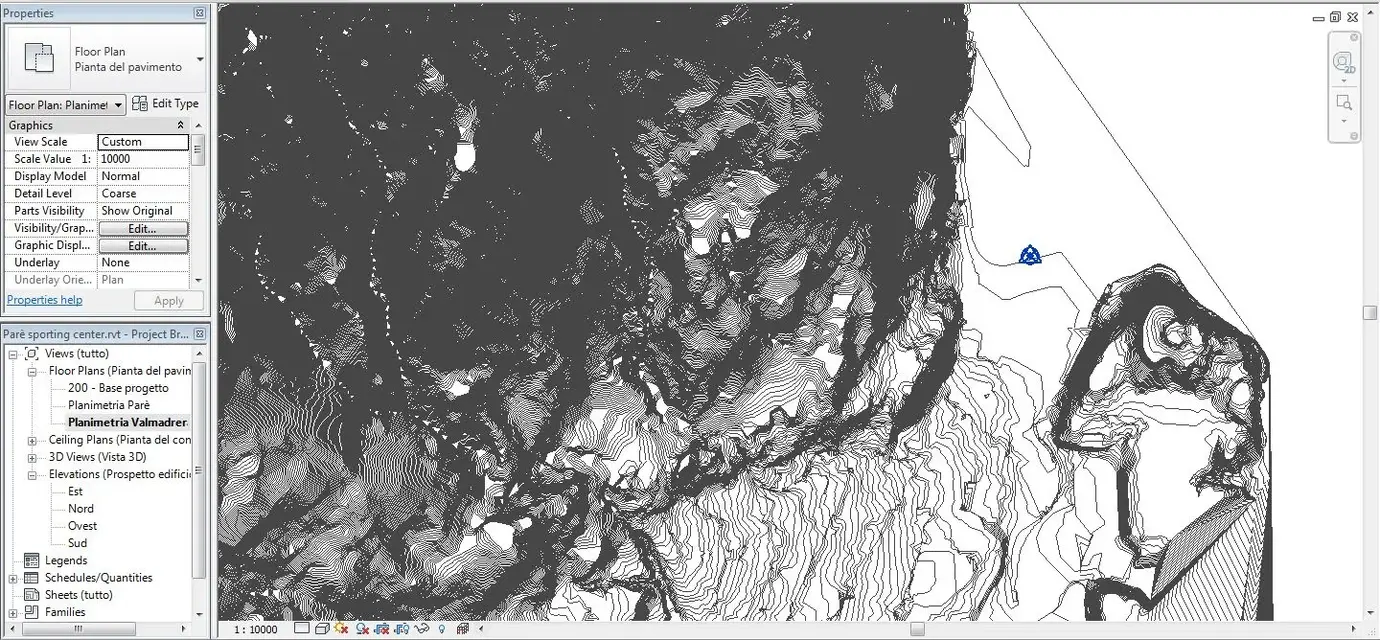

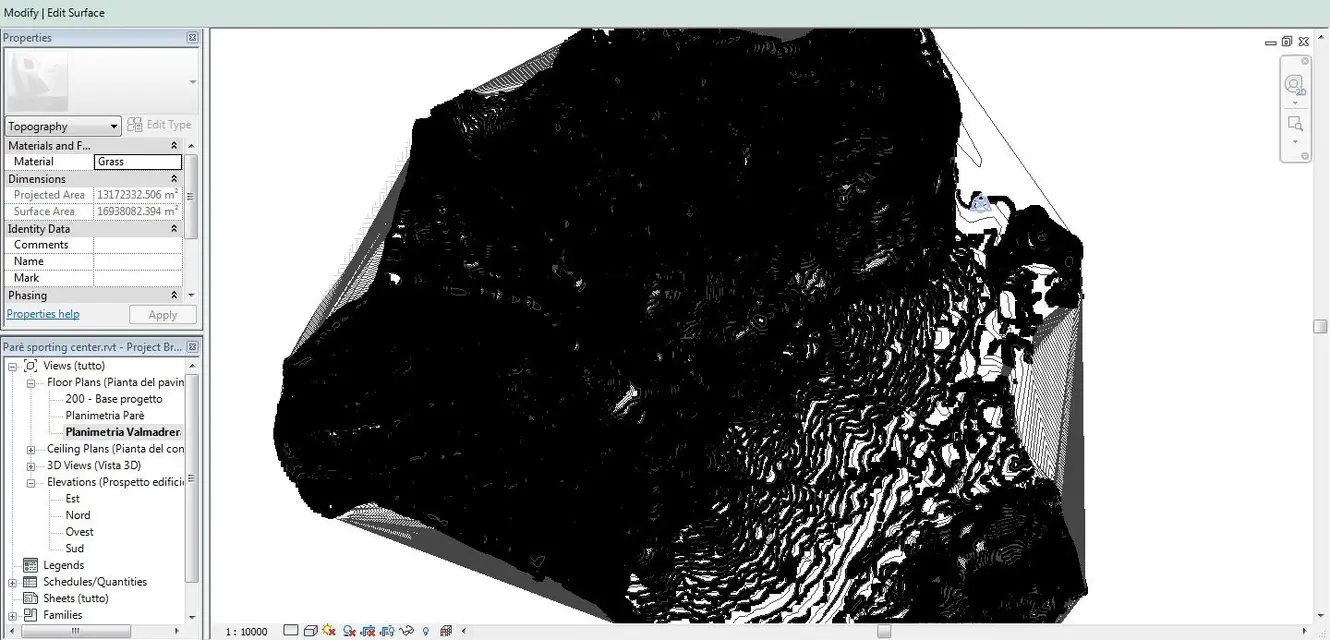

I wanted to show you some of the "pasticcio" in which I happened:
zoom of the area, to show you the detail of the level curves
cloud of points
