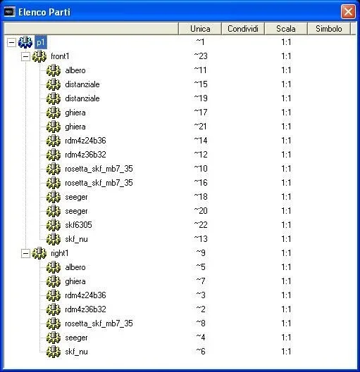

we imagine having this starting situation:
ass_01.webpwith this list parts:
lista_01.webpnow geared the big toothed wheel:
illumino.webpI would like to write a macro that flows the list parts, locates the part with the same daughter name of the front1 view
and the aggregate obtaining this result:
unifico.webpnow the macro would have written it, to reread it should work, instead it fails:
