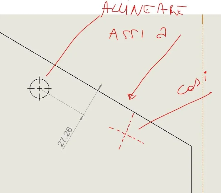

hello to all, I place an image and ask you and possible to aller the axes of a holes to a edge of the design??? in the case of the image I have to quote the hole from the tilted edge, but the axes remain ordered according to x and y of the sheet
Thank you very much

in the feature manager tree when you click on centering notch you have:
place the corner you need.

Nice picture. How did you do that?
if the angle is 15,536642 perfectly aligns it?
But it is not aligned to the edge. It is approximated, which is more than enough, but as I hope that marcoc has seen that option, I imagine it wants a parallel alignment to the edge
If I get a 44.63mm stake, I think it's true. Otherwise, I'd get the angle in degrees...
hi new reader, manual rotation and what I use now, I asked if there is an automatic way to align them to the edges, without having to quota and set the corner. because then in case you change that remains there and does not follow the edge
an escamotage would be to draw them by hand and not by function;
some tenth degree of difference accepts it as linear, but if you observe it not quota from the line, but from the center of the hole
Perhaps it is the case of proposing the addition of an option for alignment of the centering pockets.
I don't know. .
if quoti taking the edge of the hole instead of the heel of centatura the problem does not arise.
in fact on the quota there are no problems because she aligns to the edge, but then you find the axis in a direction different from the quotation and not very pleasant to see besides that not correctly conceptually.. but at the end I continue to do as done until now the handwheel when I happen
thanks to everyone
