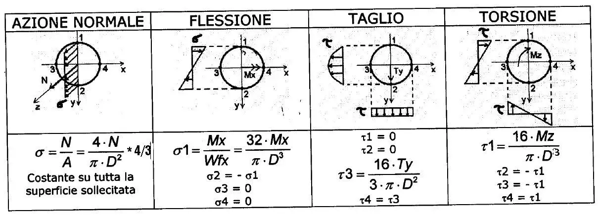

I've been thinking about the four quadrants, but there's something wrong with me:
- sigma z date i.e. that due to n is constant (ok with you)
- tau z is given by the long twist z, mz. therefore it is constantly tangent to the circumference.
Why don't I find myself with mz? Why do you have moments in your accounts?
for the reason you said... mz from place to a tangential tension that is constantly tangent to the circumference. . I bet according to x and y axes and the result is what I wrote (including sign)
incorrect corrige post #2 to solution.jpg picture 3:
max = tauz+ tauxand not with the minus sign as I wrote in the image
Sorry if I write under this old post, but it seems to me that the maximum cutting formula for a circular section (referred to the figure I attach and found above) is 4/3*t/a and not 16/3*t/a.1675704969740.webp
Sorry if I write under this old post, but it seems to me that the maximum cutting formula for a circular section (referred to the figure I attach and found above) is 4/3*t/a and not 16/3*t/a.View attachment 67641
max in circular section is 4/3 t/a. comes 16 because it multiplies with the 4 of the formula of the area.
