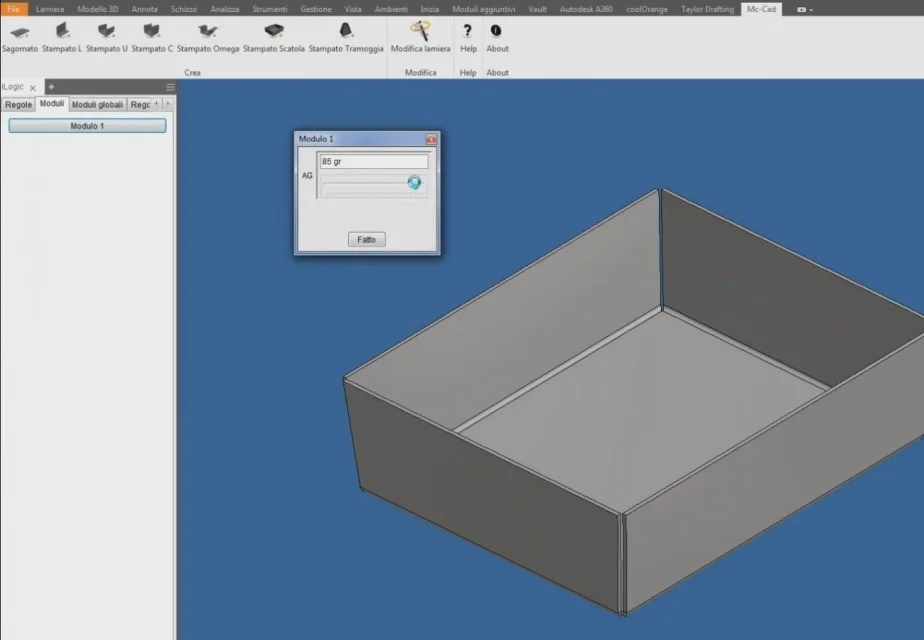

good evening to all, I just started using inventor, so I apologize if it is a trivial question or maybe already requested, but I did not find it. my question is, is there a function to create the 3d animation of the bending of a sheet? I explain better, I design a cassette in sheet format, I create the various flanges, I create the annotation of the fold order and until we are there. but is there a chance to see a movie where my flat sheet bends?
the only solution is to use ilogic and animate the fold angle/s
see photo and sheet 3d with mudulo iogic attachments

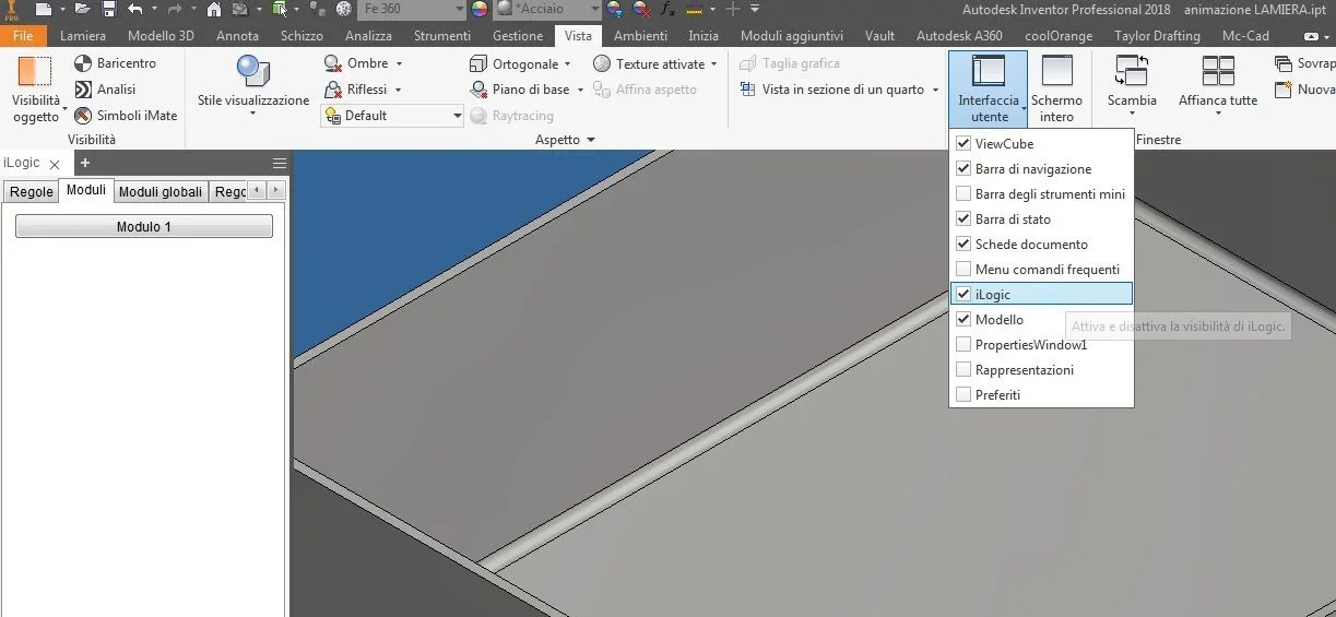

you have to activate the ilogic browser
drop-down menu view- user-ilogic interface

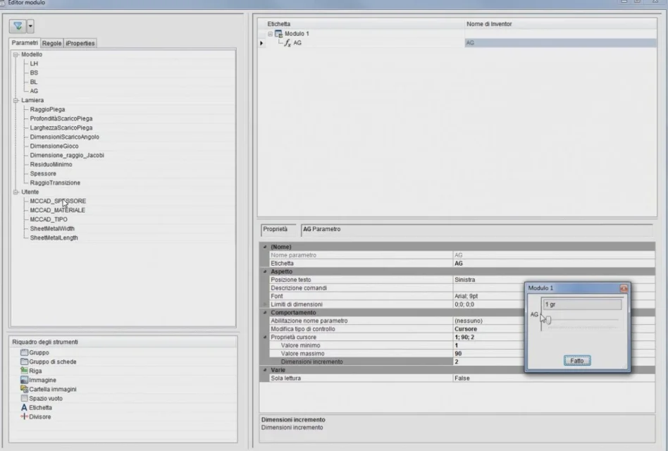

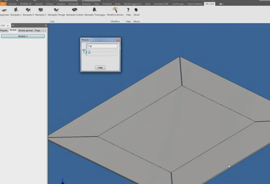

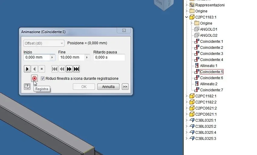

perfect, I'm here. I just have to do it manually. Doesn't make me export a video until it folds?
no, the recorder only works by animating the bonds together_foto__156.webpwhat you can do is use a screen recorder
