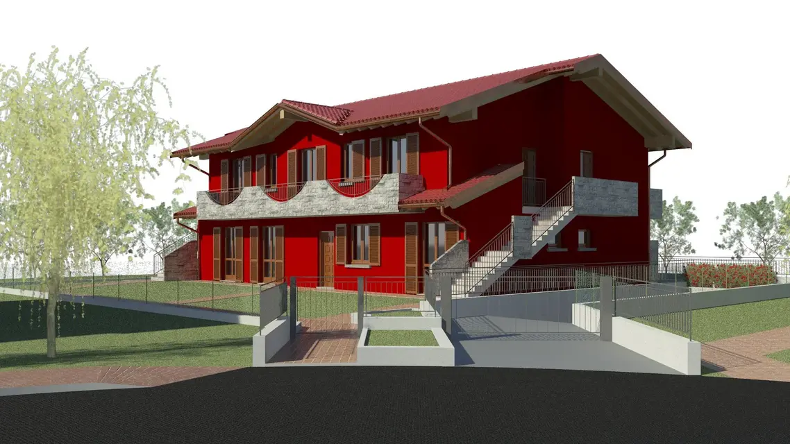

Has anyone ever posted animations made with revit?
this is a test made again with 2009

Oh, my God. !
but how did you make the plugs?? and half moon railings? ?
Congratulations again!
I believe, but the last word obviously has to make54 that the couple created them with the family of structural beams and the half-moon railing or with blanks cutting the surplus part or modeling it in the balustrade family........:finger:
Congratulations on the job.
It would be interesting to know the procedure to make the plugs, maybe by posting some tricks. . At least for me I'm a pig!:biggrin:
Unfortunately for the couple at that time I had not yet the structural beam and as I am a maniac I exported the 3d of the falde in dwg, I opened them in autocad and I placed over my tegoles 3d in dwg that as I did in autocad occupied a bit misery and then the dwg I reimported it in revit, nailing me
I was forced to turn on the layer only when I sent to make
for the balustrade since they are all the same I built it as model 3d,
Maybe you can do parametric but I didn't want to waste time for cimentarmici
Unfortunately in order to post it I had to decrease the size, the original is 769x576 and is much sharper,
I had also made a test in hd 1920x1080 but the times were stratospheric
I attach the first frame to 1920x1080
I usually make animations in single png frame after that for a couple of times it got stuck all losing the avi file after several hours of processing then the amount in virtualdub that me joins them

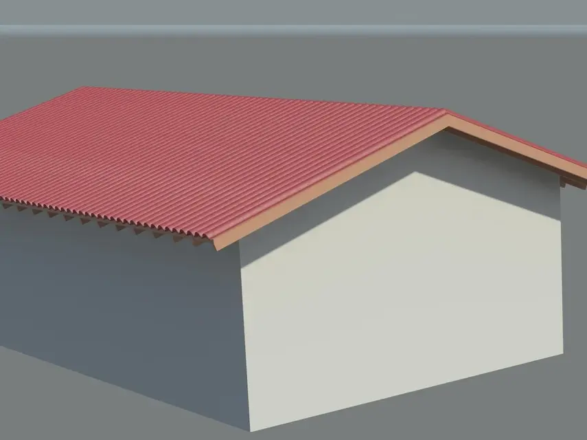

returning to the roofs with 3d tiles I found this roof going here:
type no google: autocad-revit-arquitetura.blogspot.com
I opened it and it seemed interesting to me I have to understand how they did it and how can I do it myself
if someone has time to study it and explain it to us....
moving me in revit + to which you arrive with that address I also found the connection to a movie that explains how to build this type of roof
I reopened the file and I understood everything
for now I've made the beams, the assist and the plugs
allego test
now you have to find an adequate mapping that simultaneous
the bump of the horizontal rows of the plugs
