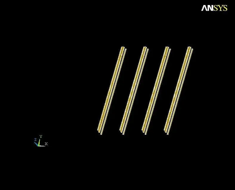

Hello, people.
I'm continuing my work on that damn panel.
between various warnings in relation to hard points, I need to copy the mesh that I made of the first "component" and then copy it to others.
tips on how to make the copy of the mesh? ?
command egen?? ?
thanks to all
with egen actually go to copy the mesh, but it will be completely disassociated by geometry.
this means that you will not be able to impose loads or constraints on geometry base and even obtain results always on geometric basis.
I think it's to avoid egen.
pps: if you want to copy both the area and the mesh of the panel on another "component" (the stringer) to solve the problem of congruent mesh as I could do?
Do I want to use apdl language or pass through the graphic gui?
