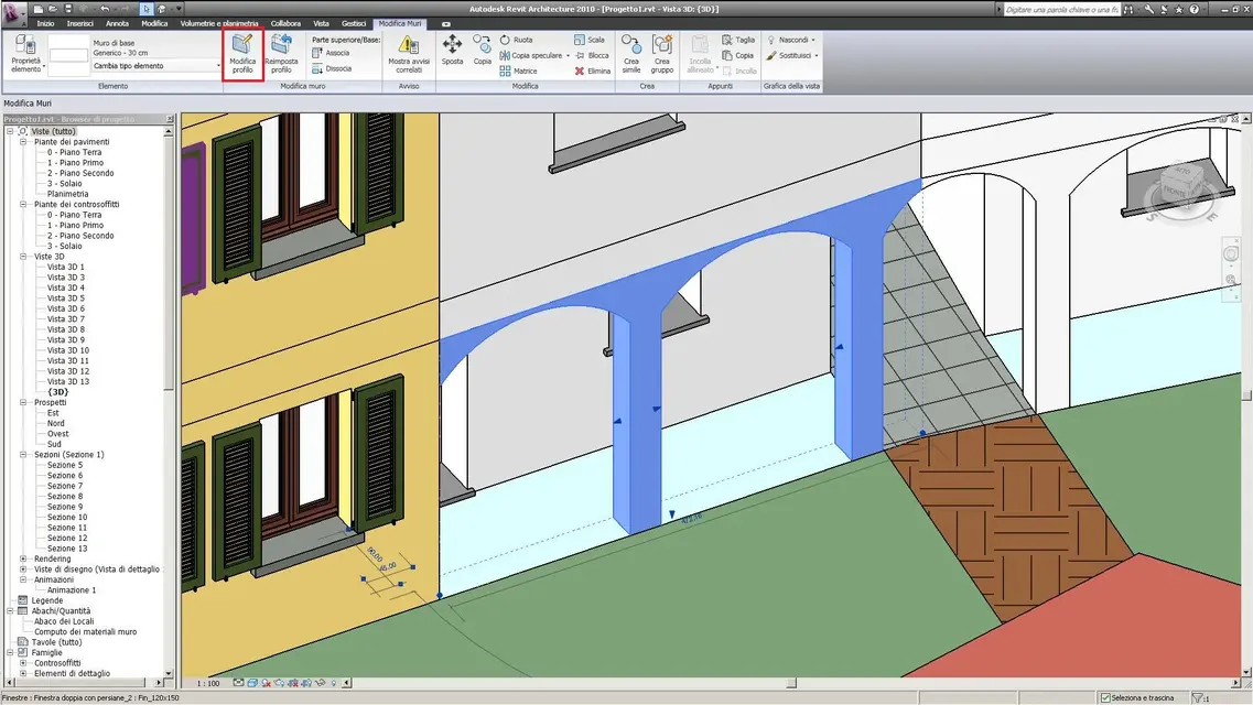

How do you make a bow in a wall?
I better explain: the doors are parameterized, there are also arches and parameterized holes?
in this regard are there families or components that can be downloaded?
in archicad (to which revit is clearly inspired) there were "doors" with real arches and arches (i.e. holes to be added in the walls, for example a portico)
looking on the net I don't find the solution and the only things about it talk about changing the wall..but I would like a parameterized thing so that from time to time I can choose the width, the height, the arrow etc. etc.

see if you understand:
image 1-revit.... think it closed wall
image 2-revit.... the selection: the wall is blue but see the blue dot telling me how the wall was before
the image 3-revit.... change: you will appear the border of the wall in purple, you can redesign the profile of the wall and in which your arches
or build a family that allows you to pierce the wall parameterically, but this is another speech
