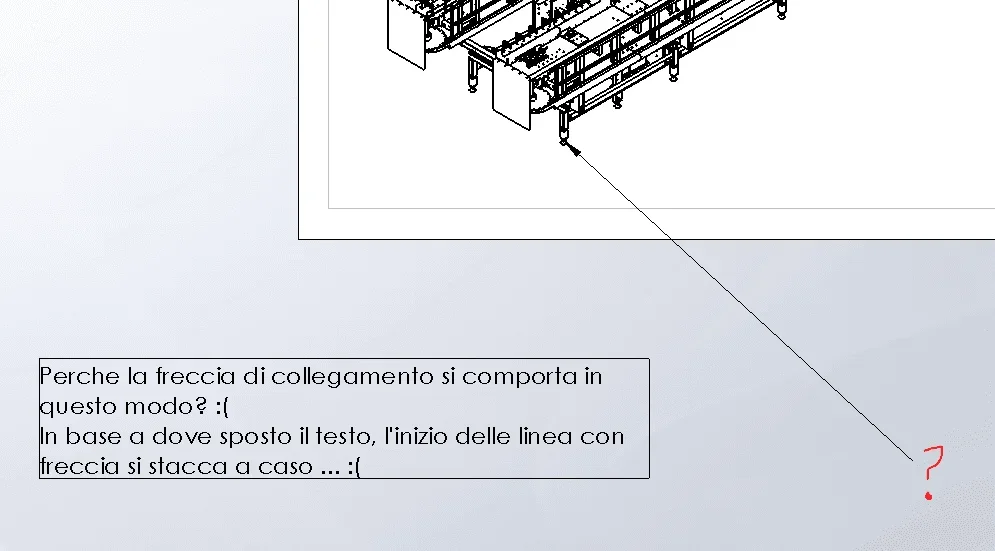

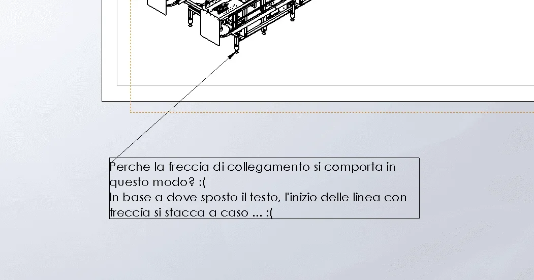

hi to all, from this morning, without changing anything, I find myself with a strange behavior of the arrow that starts from the text and points to the piece: allego 2 images of the same note moved on the table:
Why does the connection arrow behave like this? :
based on where I move the text, the beginning of the line with arrow is detached and placed randomly ... :(

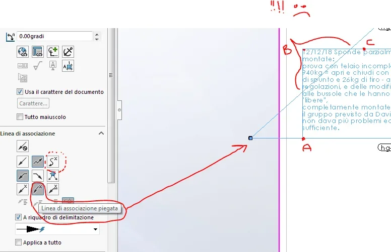

put folded association line

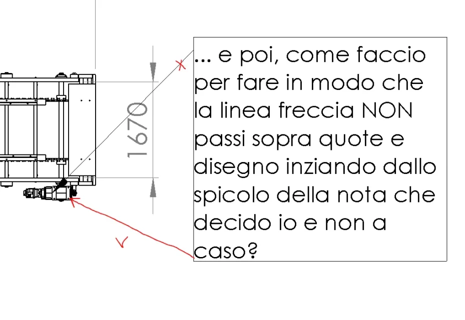

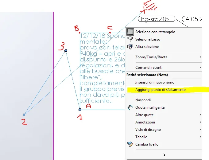

thanks massive, I in that way but can not move from "a" to "b" or "c", 1549441683309.webpTrying with add staggering point, I get that!1! does not move, "2" moves only horizontally, "3" is free and I could put it by hand in "c", but it would remain "2" around... and then if I move the note, the line does not follow and it is all to be done by hand...:(1549441863661.webpat the moment I will solve with line of association spline ... even if it is not very "technical" ..1549442057966.webp
both. if you put the icon with the star, the one under the spline, does automatic positioning however always not manageable independently
