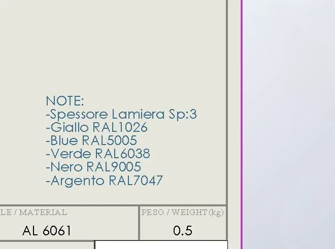

Good evening to all,
probably it's an argument already dealt with, but aimè I searched and found nothing... .
I need to see the aspects assigned to the surface of the model in the table to make serious plates. . indicating the reference color ral, without having to write it manually. . .
also only as a list
Has anyone ever had to do something like that?
I have attached pictures to explain better

I had not read the answer of the other discussion.... I read and answered.... thank you very much
in this case we talk about a part with a single body, where I assigned the properties of the aspects to distinct surfaces. . .
from what I saw and tried it is not possible to connect the note to a color (even if it was a body or part together).
you can instead create a set of properties of the file in which to specify, manually, the various colors; in this way the note can be connected to the property and wanting you can insert a table (different materials) reepilogation instead of a simple text as in the third image.
Okay, thanks for the answer and the evidence you did.
Unfortunately, the solution you have proposed is what we are currently forced to do. .
Thanks again
