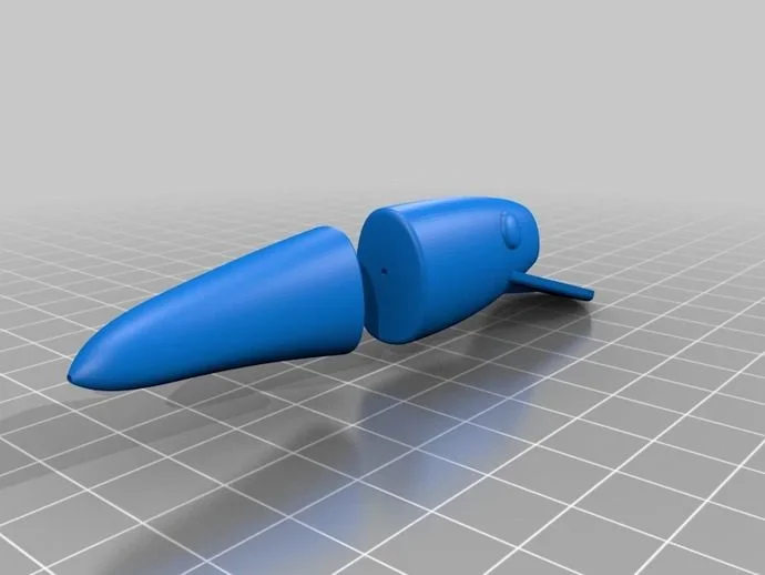

Hello guys, I was wondering is it possible with autocad to make something like this?

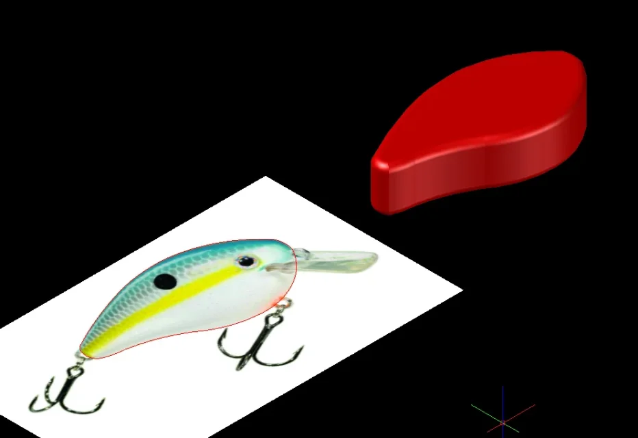

0001.webpI can not extrude a form following two different lines of trajectory, that is, as in this cado as it is possible to create a similar form with autocad?
boys here is an example, more or less I managed to draw the shape, but the problem is to succeed, like changing the sides making it more round and homogeneous using solids because it will have to be printed.... how could I do?

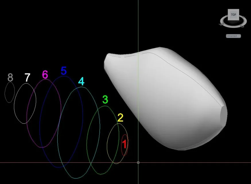

with the loft command but you have to draw the fish in cross sections to the drawing you have already made
I tried but it creates me surfaces, I need it to remain solid because I have to export it to stl
loft.webpmaking a loft between the sections, get a solid.
of course more sections = more realistic result.
