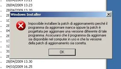

I downloaded the 2 updates:
inventor2010_sp2_x86.msp
inventor2010_sub_advantagepack_sp2_x86.msp
I wanted to install the first but crashes by checking the error message (see image attached).
I tried to install the second and it's all smooth, I tried to start the first but nothing to do, always that message.
the sw is iv routed systems 2010, already with sp1.
Where did I go wrong?

I guess I didn't explain well. do not need to install two files... If you have the sub pack installed, you must use the second file you listed, if you don't have to use the first one.
If the second you have installed correctly, I suppose you have the sub pack, so you're fine like this, you don't have to install the first file.
the 4 files found on the site are 4 "versions" of the sp2, depending on whether you have the 32 or 64 bit and the subpack or not, you just have to choose the right one. among other things was so also for the sp1:smile:
