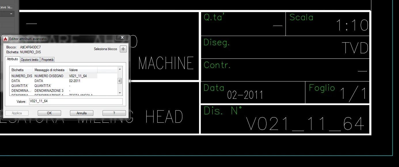

I would like 2 fields of my cartiglio, which I currently edit manually through "advanced attribute editor", to be automatic. use acad 2015Cattura.webp1) "dis.n°" must be the name of the file that I impose from explorer (e.g. "xxxx.dwg" without extension obviously in the chart):
2) "date" must be current month and year.
How can I do that?

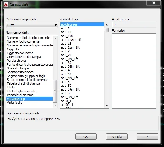

no repetitive, take off at the end of the .lsp but I do not find the field that I addedCattura.webp
without resorting to lisp,
just copy/paste this directly into the cartiglio
%<\acvar filename \f "%fn2">%
