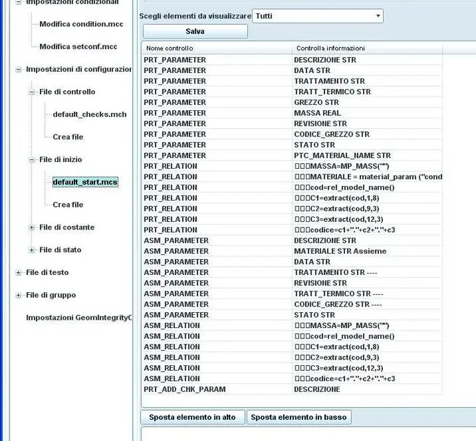

I've been accusing myself to this discussion (after reading all that analogous) because for too many hours I've been freaking out with modelcheck and "you don't want to know how to do what I want!"
I have to check and add parameters to the prts and asm so that I have a basic configuration of the parameters to be exported then into an access table.
I threw out on model check like this:
-imp. initialization, unchanged
- conditional impe, unchanged
-imp.configuration
- control (add_chk_param=y;paramcheck=y)
- start (see image)
- constant, unchanged
- status, unchanged
- text file, unchanged
-Unchanged group files
I interactively control a prt that does not have the description parameter and does not signal the lack and therefore does not give me the possibility to add it.
I forgot... use creo elements/pro 5.0)
What's wrong? I'm sure I'm wrong, but I don't understand what...
an early thanks
