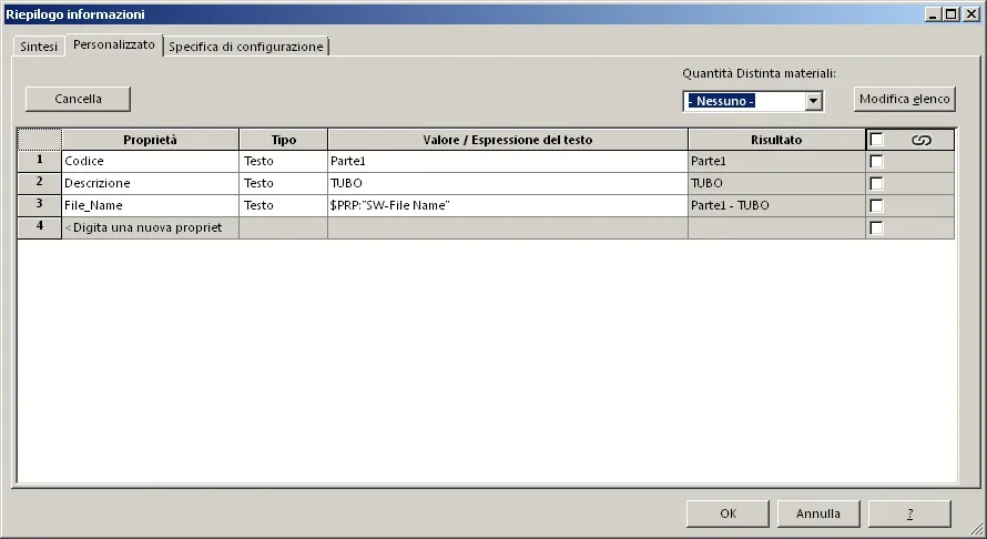

you have to create a macro that performs what is expected, there is no solution with standard tools
exists a solidworks way to compile two custom properties according to file name?
for example in my files I have two properties: code and description.
if to the file I give the name 1234 - pop, I would like that code to be completed with 1234 and description with poplar.
Can you do that?
