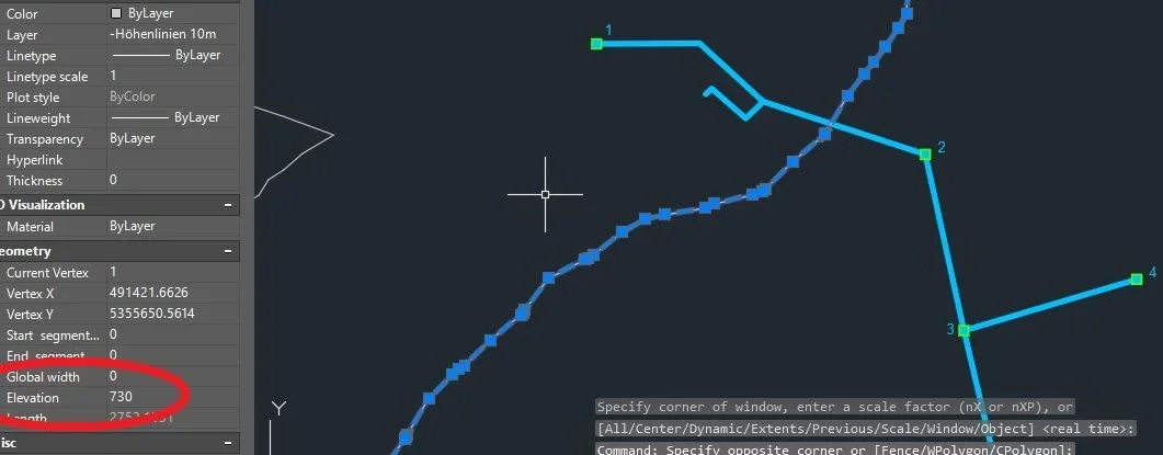

Good morning to all,
I write you to have an opinion on the feasibility of an operation that would be very useful to me to do automatically.

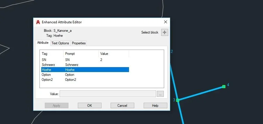

trying to be concise and clear, in my dwg, I have a block (the square you see in the picture1) within which are defined some insertable attributes by hand, including "hoehe" which would be elevation. the polylinea that you see in the image2 has automatically between the attributes "elevation", coming from google earth (the polylinea represents the level curve).
My question is the following. is it possible to make sure that the block attribute goes to look for the nearest polyline and "import" the elevated value in the hoehe field?
maybe through a lisp or vba code is possible?

hi, for the attribute I don't think you can do such a complex automatism but you could create a text line, "put data field" and give it as an "object" selection by selecting your polylinea and tell it what parameter to indicate. if you move or change that polylinea the value would be updated. Obviously this would be done for every single polyline. Other ways don't come to mind.
p.s.: the world is small!
Thank you. at the end I am perfecting from qgis an escamotage going to take the value of quota from the dem that in turn I create from the curves of level. but it works. When I have time, I will try to find a more automated solution.
