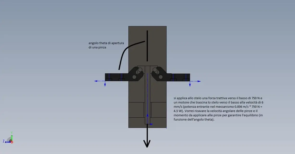

thanks to the answer, in fact it is difficult to understand only in words. I attach an image of the scheme with some comments, I hope that now the problem is clear.
Hello and thank you!
