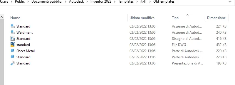

I've tried to go to the templates to delete the saved file, but I wouldn't want to combine anything to erase anything else.
Thank you very much
seems to be okay, and if I open that standard ip correctly opens me a ''empty'' fileerrore ipt.webp
thanks I solved, the file pointed not to the public document folder etc. but to the inventor environment 2023, in there I modified the part by deleting the model and saving, still it is not clear how I saved it in that way.
I imagined it was a banal mistake, thank you very much
